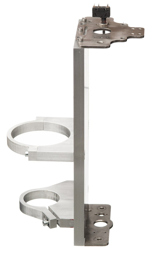

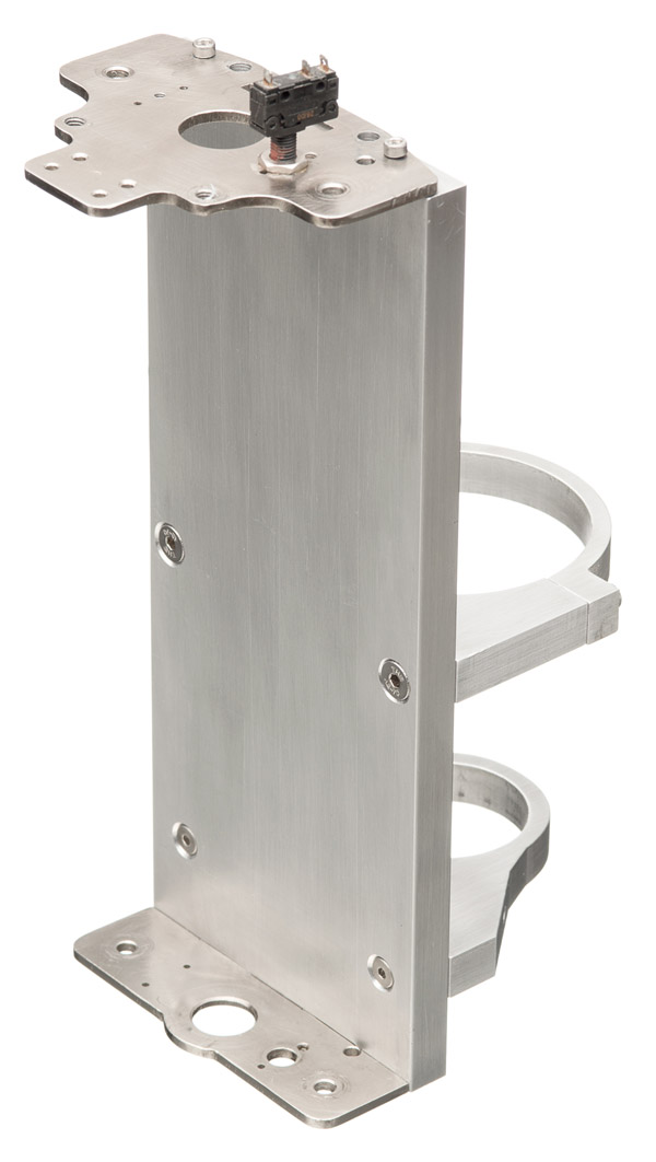

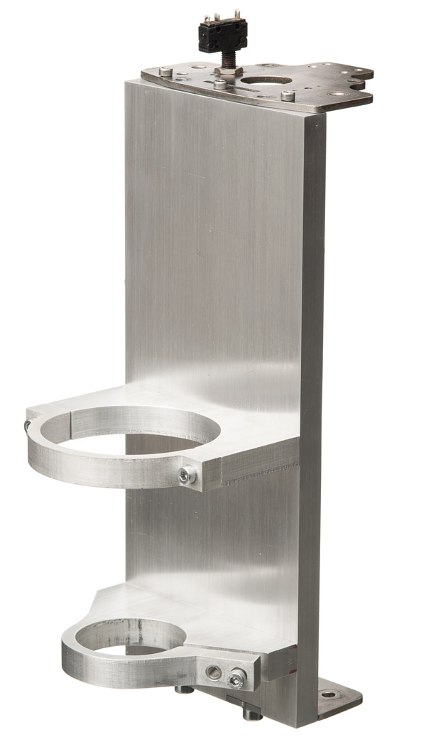

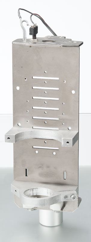

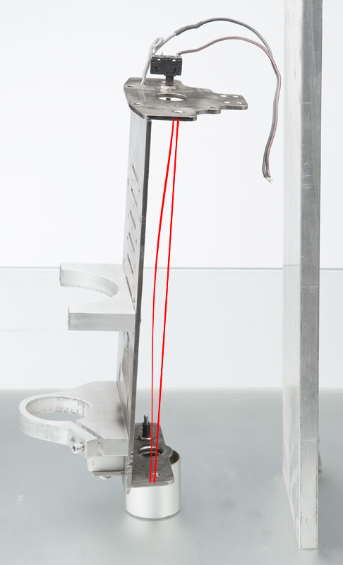

By attaching  the Kress engine the way I did
the z-axis bends in one direction when used.
I found out with heavy using the round holes become slightly oval.
My plan is  to replace the vertical plate by a 12mm thick aluminum plate.
then use the same brackets for the kress motor.

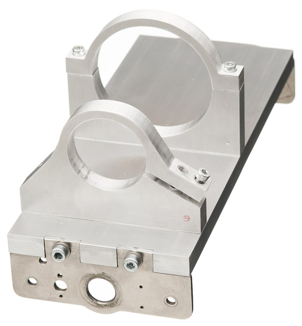

I am now cutting and sanding the 12mm alu block.
Without an CNC machine!
I will soon post the result here.

@ Chris : What do I use to glue the bearing to the lowest plate ( CA glue ? )

The bottom bearing does not need a seat / support and was self aligning.
Once the driveset is in position and running smooth,
you can add a drop of loctite thread locker to the edge of a bearing and
the bottom plate - if wished.

Made them myself.
If you like I can search for the Cad file.
Oscar
